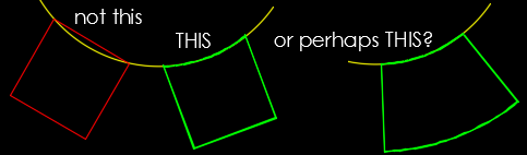

Hello. I´ve been dealing with this problem since yesterday and cannot find a solution.
I´m treating with the road infrastructure proyect and need to draw different-length polygons alongside the road. The objective is to import those polygons later in ArcGIS.
The polygons must be stuck to the road´s shoulder. On parts when the road is straight it´s easy to create a rectangle with needed dimentions and just "stick it" to the road. The problem arises when there is a curve. I cannot create a polygon with curves so I create polylines and try to close them. When I do close them, they generate new lines that I don´t want.
Is there any easy and efficient way to create a polygon of certain length and width that is stuck to another polyline and adapts to its shape?

To clarify, is this what you mean [exaggerated curvature to show the issue]?
Where should the length be measured, compared to the rectangle edges that lie along straight  curbs?  [As shown, the chords  of both green arc sides that lie on the yellow curb Arc are the same length as the edges of the red square, so that arc edge is longer.]

Hello, the last solution (second green rectangle) is exactly what I mean! The whole polygon should adapt and change its form alongside the curve, not only one side.

I can't imagine an "easy" way to do something universal -- you're probably going to have to build each one.  But that's not too hard.  Copy the curb Polyline in place, Break the Copy at a known end of where you want your shape to lie, use Lengthen's Total option to get the remainder to the length you want along the curb [if that's the basis -- need an answer to the question below my image], Offset it by the desired width, draw Lines between the ends of the two, and Join the four pieces into a Polyline.
If the nominal length should be at mid-width  of the shape, Offset the curb Polyline [instead of Copying it in place] by half the width, do the Break/Lengthen thing on that, and Offset that both ways by the same half-width, draw the end Lines and Join.
EDIT:  I guess you should Offset the curb Polyline for the entire string of things, and Break it up appropriately, rather than do the whole thing for each shape.  If it's a regularly-spaced  thing you're talking about, you can draw one  of the shape-end Lines perpendicular to the curb, and use DivideMeasurePlus.lsp and its MEA+ command to spread it along the route, and then just Trim out appropriate parts, and Join the collective result into Polyline shapes all at once.
