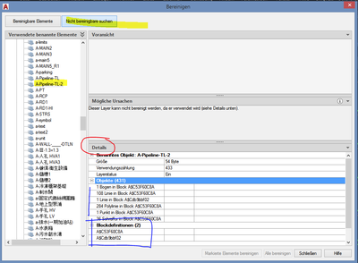

Hi there,
I cannot delete a unused layer with no objects shown through qselect command with the condition ,ilayer =A-Pipeline-TL-2 .
The given layer is "A-Pipeline-TL-2" and the relevant files and images are attached.
Can anybody help me? Thanks in advance. 🙂

>>"Can anybody help me?"
a) "qselect"
    qselect will select all 1. unnested 2. graphical object in the 3. current space only.
    Three limitations and the reason why qselect is not the answer for all questions.
b) "I cannot delete a unused layer "
   The Layer 'A-Pipeline-TL-2' is used, multiple times!
  If you are running Version2020 or newer: Start PURGE dialog,
  switch to non purgable item option, select your item (layer 'A-Pipeline-TL-2') and read about the references
431 objects inside two blocks are refering to this layer!
Both blocks are purgeable,
so the solution in this case is: Purge the blocks first and you are able to purge the layer then.
In a(nother) case you can't purge the blocks (because you still using them),
use BEDIT to edit the blocks and change the layer of theses 431 objects.

@nosurvive
Purge command after that got rid of your unwanted layer and everything else not in use
Blocks.................... | Purged : 15
Registry Applications..... | Purged : 26
Layers.................... | Purged : 14
Dimensions................ | Purged : 3
Groups.................... | Purged : 189
nosurvive
It works when I try, Thank you. But I wonder what happened to the affected blocks and layers in them.
