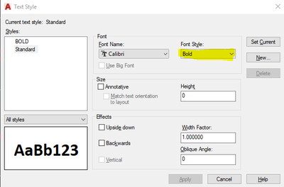

In the mean time, try changing your Style to use the Bold style of the font to see if that gives you better results.
John Vellek
Message 7 of 9
Wow! The bold worked great!
