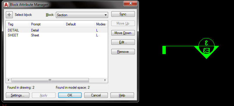

BATTMAN will help you.you need to Synchronize the attribute. type battman in command line then select the block then press Sync icon. see attached image.

That works the same as attsync. The problem is that when it syncs the block it moves the text over to the line work, I need the line work moved over to the text (the text always stays in the right spot). It happens randomly, so I may have 50 blocks in my drawing and when I go to open it the next day its a mess. Is annoying having to move all of the blocks back into their correct spot.
