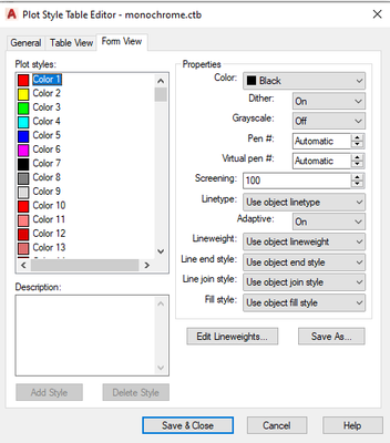

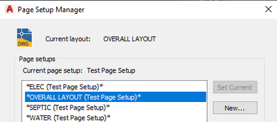

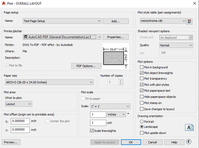

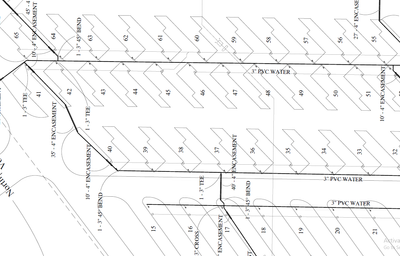

I've spent > 15 hours the last 2 weeks week delving into the world of lineweights and plot settings. I've been able to get everything set up perfectly, EXCEPT for one thing. If I print a single page by itself to PDF, the default lineweight (which I set using LWEIGHT) shows up correctly (I set it to 0.00mm to make it painfully obvious). When I Batch Plot, everything shows up fine except for the default lineweight, which it looks like it resets it to the autocad default value. What I've tried:
Creating my own Page Setup (shown below)
Lineweight in Plot Style Table Editor is set to "Use object lineweight"
Applied that page setup to each individual page
Made sure that page setup was actually applied when batch plotting
The following two images show a screenshot of the results of printing and plotting. The obvious thicker line I've set at 0.5mm while every other line is 0.13mm
Printing Individual sheets (what it should look like):
Batch Plot (what it does look like):
When it comes to printing/plotting/lineweight issues, I've read through everything because I've had the same problems as everyone else over the last 2 weeks (I can't believe this is such a huge topic!). This has me stumped, it almost seems like printing a single page by itself uses the default lineweight I've applied (0.00mm) and when batch plotting, it uses the autocad default value for default lineweight (0.23mm or something like that).

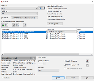

PUBLISH RULE OF THUMB THAT ALWAYS WORKS:
1. Launch Publish from a drawing that is not part of the publish set, but is configured with all your possible sheets and plotter options.
2. Bring in all the drawings/tabs to be published.
3. Import the pagesetup desired from the template file (in your case, one set up for exacting desired output).
4. PUBLISH.

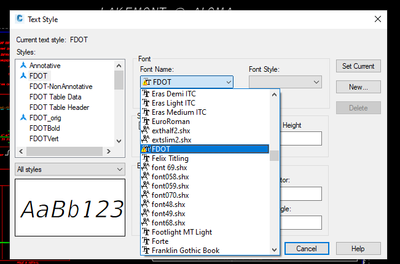

@bcsurvey what fonts are you using in your DWG file? That's the problem being reported.
Try this  as a test too
Message 6 of 12
bcsurvey

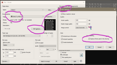

I work for a company that does a large amount of state-funded roadway, lighting, ITS and signalization work, so in my case, there's also the FDOT state kit that introduces proprietary layers, styles, settings, blocks, fonts, etc.  So this is what I'm seeing:

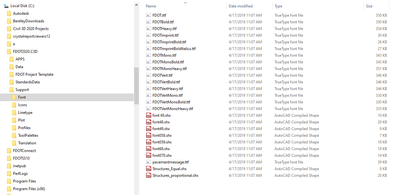

as for the pdf options, I have had the "Capture font . . ." box checked.  Here is the folder containing desired fonts:
This path is included in Support File Search Paths

>>>... I have had the "Capture font . . ." box checked...<<<
@bcsurvey Interesting, because your PDF driver/ viewer does not seem to think so when it report "...Capturing fonts for this drawing is recommended...."
Are you using a different pagesetup/PDF drivers perhaps?
Message 8 of 12
bcsurvey
That does seem to indicate a disconnect . . . I also hit F2 after opening C3D and also after opening each of the 2 drawings in question, and the only font not loaded (substituted) were 2 obscure ones font001 and font011 - not the issue I'm fighting with, which is font "FDOT'.  I see this yellow error triangle but there are no hovering or right-click options that indicate details.
No doubt it's just not finding it, although there is "FDOT.ttf" as shown above.
PS - If I hadn't said it earlier, these drawings contain items from 2011 +/- .dwgs and a coworkers initial assessment was either that the state kit was corrupted and needed uninstalling/reinstalling (which has been done about a half dozen times in the last year) or that the old objects were somehow corrupting or blowing out a setting or reference path.  I can still plot each sheet individually and get the right font to display, so I'll do that for now, was just wanting to get a firm grasp on what was going on exactly.

The yellow exclamation mark means that font is missing (or in this case perhaps it is corrupt or not in the correct Windows Fonts folder, just in the AutoCAD search path which is useless for TTFs).
Either way, it is not being used/is ignored/is being substituted: you must have that important alert at startup to warn you of these things turned off. Turn it on, restart C3D and open these files again and see what comes up.
