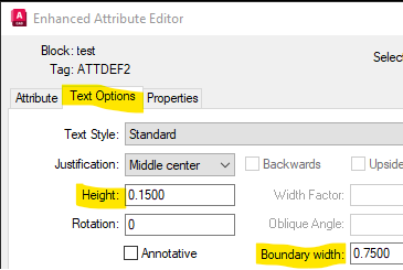

@Luke_Y.AGII wrote:
... id still like to know if it is possible to make text with attributes fit in the space (multiline style), and resize itself ....
It wouldn't do it by itself, but it's pretty easy to adjust all of that in the Attribute Editor:
That applies to the right side here [the left side is with 0.2 height and no boundary width]:
You can define the justification and a boundary width for a Multi-line Attribute, so it would automatically go to multiple lines if it gets too long, and be centered correctly, and all you would need to do manually is adjust the height.

I got into your drawing, and changed that Attribute to be Middle-Center justified and centered in its box, and I inched the boundary width up to 3" [closer to the full width of the box].  Inserting it and giving that one a too-long value, I got this at first:
which did the wrapping itself to stay within the box width.  I double-clicked on that Attribute, picked the Text Options tab, and reduced the height, and [this was unexpected] found that I had to pick in and type in [i.e. "force"] the 3" boundary width again, or else it remained in 3 lines with a proportionally shrunk boundary width.  So I was a little disappointed about that part, but it's still not a lot of work to fix when the situation arises.
Kent Cooper, AIA
