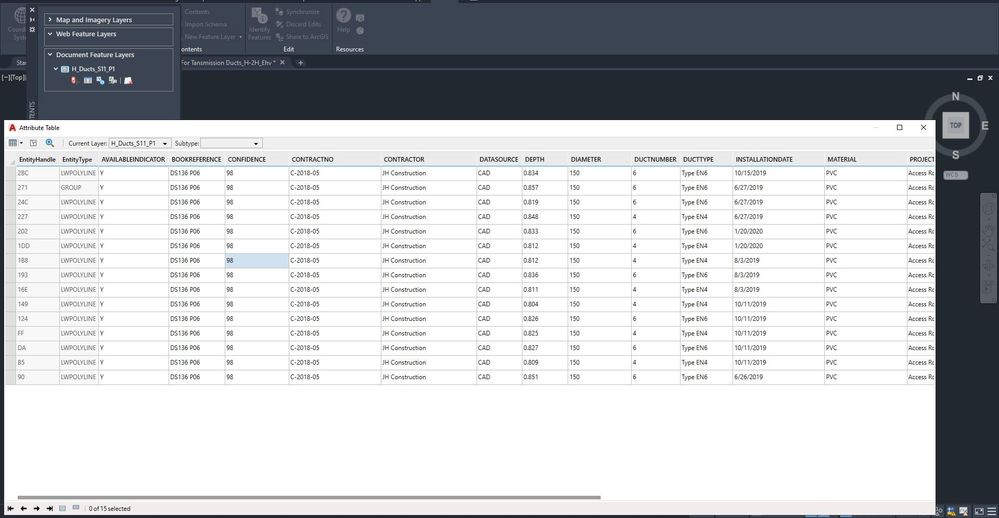

Hi Everyone. I'm trying to much the content of the attribute table 1 (The filled one) to the new empty cad drawing like the installation date on installation date and so on. any solution fir that pleasCad Table 1.JPGCad Table 2.JPG

An easy way to bring Object Data Tables into your drawing is just by dragging a drawing know to contain the tables into the view frame of the drawing you wish to add the tables to.
Once you are asked to specify insertion point, simply press ESC.

jamatuseski
Please see attached for a quick video. I cant recreate your scenario exactly as I use Map 3D to work with this data and you appear to be using the ArcGIS extension for AutoCAD, that said, this should get the tables in your drawing, from there the workflow will be within your ArcGIS extension.
