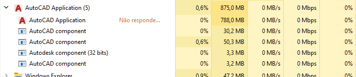

In more os less 4 months, the Autocad 2022 started with freeze each 5 minutes (and the duration of freeze is about 30 seconds),...I bought a new computer (Nitro 5 with 16gb ram GTX 1650) and i'm with the same issue (i have two computers, both ACER)...
I realized two interesting things.
1 - When i open AUTOCAD and REVIT at the same time, the issue simply disappears...
2 - The freeze interval and his duration has exacly the SAME TIME...FREEZE occours each 5 minutes and the freeze duration 30 seconds (and again again again)
Here i have a printscreen of my desktop manager, that show us the "Not responding" during the 30seconds of FREEZE.
Here i have a printscreen of my desk manager, that show us the "Not responding" during the 30seconds of FREEZE.NOT RESPONDING.png
Please, help me...this issue has been harmful for me bcuz my work is being harmed...

It worked !!! I tried the Autocad 2019 and the Freeze disappeared...Thank u so much 😉
