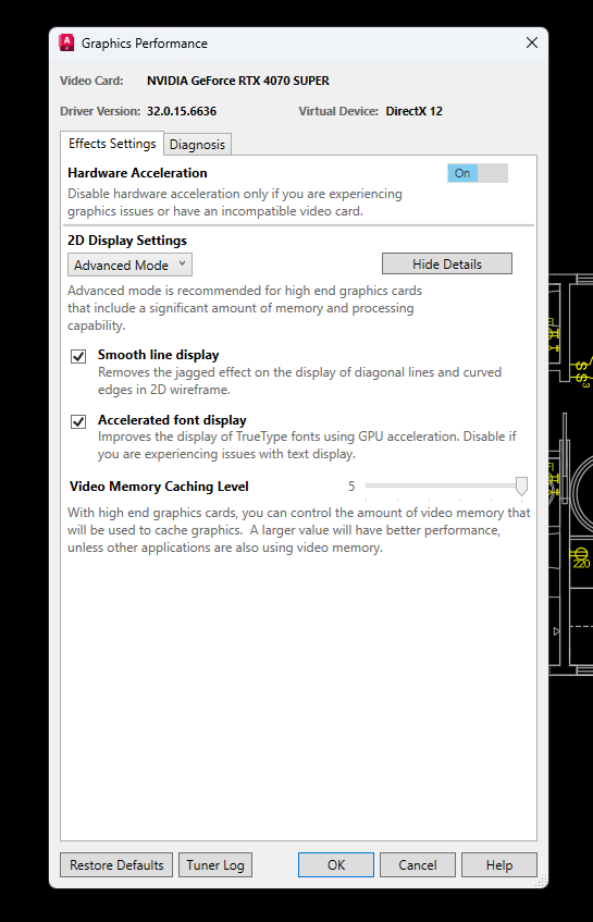

@vblevin Share your problem DWG file here, point to these objects, and also provide screenshots of your AutoCAD's ABOUT and GRAPHICSCONFIG commands pop-ups please.

Thanks for the file: no such issues in LT2025.1.1 here for me at all with your file.
have you tried everything listed here yet https://www.autodesk.com/support/technical/article/caas/sfdcarticles/sfdcarticles/AutoCAD-LT-When-se...
Also try this - Set GFXDX12 variable to 0 (that's a zero): a restart of your AutoCAD/LT2025 is required for it to take effect.
Consider turning off LINESMOOTHING and LINEFADING variables after that.
If still no relief then start GRAPHICSCONFIG command and change the 2D Display Settings pulldown from "advanced mode" to one of the other choices.
If all else fails, then turn off Hardware Acceleration as a last resort. Anything different?
