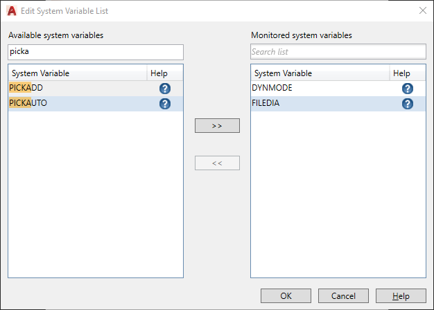

nrz13
Add PICKADD to your System Variable Monitor to be alerted the next time AutoCAD randomly changes it (and more easily change it back):

nrz13
It's not showing up for you?

nrz13
What version of AutoCAD are you using?  I'm using 2022.1.2 and the variable appears for me in SVM.
