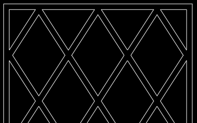

I am pretty enew to autocad, and I found very difficult to draw a diamond lead glass pattern.
I got so much difficulty calculating diamond sizes so I wanted to ask if theres any way of doing this.
Lets say we got a glass size 1195 x 403 like below:
And I want 3 diamonds in the width and 6 diamonds in the height with 12mm thickness. How to calculate them sizes? I would really appreciate any help with this.
Many thanks

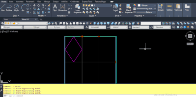

As much as i understand your issue ..
  • By DIVIDE command .. make your needed parts ( 3x6 ) as i did ( Red blips ) .
  • draw lines between those blips .. then draw diamond shape with PLINE command .
  • Now use ARRAY ( Rect ) command .
Click on below image to see how it works .

tromekhimself
Thank you for replying.
The issue is, that all the diamonds need to be 12mm thick and fit into the frame. It suppose to look like this roughly like this:
Thats a antique  diamond lead pattern in the glass. I dont want any of the diamond leads going over these cyan lines.
I hope that helps you understand what I am after.
