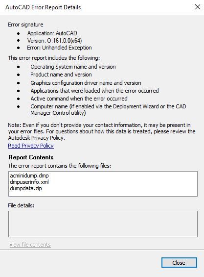

>> when crashing: Unhandeled exception.
Is it always the same exception? Can you upload a screenshot of that message as well as some info, what you did (last commands) when it crashed?

Hey Alfred,
Yes always the same drawing. Here also some screens from it. I've also searched for a solution to find out how to read the dump files, but did not found it. Now trying your "recover all" solution.
