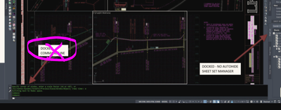

Here are the conditions I see - labeled.  The first image is how I have things set (how I wish they would stay).
The second image is how my SSM gets relocated (when it isn't just made taller than in the first image... and shortening the Properties window).  I've also dragged the floating Command Line so that it is clearly not docked.
The third image is just to show the SSM clearly undocked.

Thanks for all of that.
This is not "docked", just floating there: its not a semantics game, it's just what Autodesk has chosen to not call what you are doing as "docked".
Did you try the sequence of events to use with saving workspaces that I noted in an earlier post? You said you used it, but I want being a lot more specific about ho to use it.
And never assume "automatic save" is doing anything anywhere, always be deliberate about using WSSAVE.

I'm going to have to respectfully disagree with you.  Here is my Command Line very clearly docked at the top of my screen (the earlier image is docked at the bottom of the screen):

It's docked - like the old-fashioned style. It looks a bit weird with toolbars that are shortened...but it's the way it is.
I was fighting with C3D command line too...  now I'm using "anchored" cmd to the lower-left corner with a couple of lines. It's kinda stable.

hencoop
@ВeekeeCZ@pendean
Every now and then I learn something new.  This is one of them.
It is NOT possible to "Dock" the command line even though it is a "window".  Other windows have an "allow docking" option.  The command line does not.  I just discovered that I can expand the command history window regardless of whether the command line is "anchored" to the bottom, top, or floating in the middle (mine has subdued green text).  When the command history window is expanded, the temporary magenta history lines are replaced by it.
What I am seeing is AutoCAD changing it from "Anchored" at the bottom to "Not Anchored"... still at the bottom.  The difference in appearance is that when "Anchored" it spans the width of the drawing area, is anchored to the right and left edges and shows the few lines of command history I had set; and, when this is unexplainably altered by AutoCAD, it is NOT anchored to either edge of the drawing area and there are NO lines of command history shown.
I will try to remember to use "Anchored" to describe my locked location from now on.  Specifically, @pendean, my apologies, you are correct.  My command line has never been docked.

  8. Dock the Command Line
  9. Set SDI=0 (then do some work or not, doesn't matter)
  10. Close AutoCAD
  11. Open AutoCAD (the Command Line should still be docked)
I have confirmed that the docked Command Line is undocked only after AutoCAD has been opened while SDI=0 and SDI is then set to 1 and AutoCAD is closed.  Upon reopening AutoCAD, the Command Line will ALWAYS be undocked.  Switching from SDI=1 to SDI=0 does not have this effect.  Only switching from SDI=0 to SDI=1 has this effect.  Between forcing this to happen, I opened AutoCAD without changing the SDI setting 5 or 6 times in a row for both SDI=0 and SDI=1 and the docked Command Line stayed docked each time.
