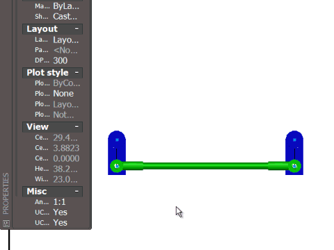

Single plane like your first example is no problem, but once an AutoCAD constraint is applied, it can't be further constrained to move in the Z axis
I need to do something almost exactly like this. Can anyone tell me how this was done?
Message 9 of 13
leeminardi
Here's a tutorial I just put together to show the steps in creating and animating a 4-bar linkage using block, parametrics and a little vlisp.
https://youtu.be/Y4VAJ5mNnng
I watched the video and it did end up helping me. I hadn't thought of using a block with both 2d and 3d elements in it to drive the constraints. Thanks for posting it!
