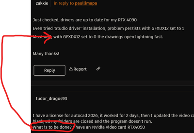

zakkie
Just checked, drivers are up to date for my RTX 4090
Even tried 'Studio driver' installation, problem persists with GFXDX12 set to 1
Must add, with GFXDX12 set to 0 the drawings open lightning fast.

tudor_dragos93
Community Visitor
Community Visitor
I have a license for autocad 2026, it worked for 2 days, then I updated the video card and I literally don't have access to the program anymore. The screen goes black, all my folders are closed and the program doesn't run.
What is to be done? I have an Nvidia video card RTX4050
