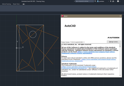

Not seeing anything like that here in AutoCAD2023.1.1 with my own blocks: are your 2023's fully updated?
Are all of your similar blocks triggers for this crash, or just this one?
If all, can you share one here so we can try it?

Thanks for the block: not seeing any issues here, are you doing more that what you stated in your first post?
