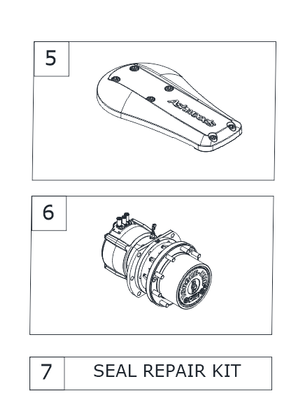

I work with Creo -> Autocad -> Corel Draw  PNG
3D Model in Creo 4.0 and export to DWG , apply some scales , layers, etc etc and Copy the image to Corel with basic Copy and Paste or import function.
When I copy the image/drawing to Corel it seems that some of the objects are filled with circles or circles show up in random areas of the image.
I have tried to use new template / new image but that didn't fixt it, I have tried certain functions/commands such as  PARAMETERCOPYMODE, PASTESPEC, CONSTRAINTSETTINGS and few other but that didn't help.
Here are few example's of AutoCad and PNG
Corel  Circles around object with number 6 box,
Another image
Corel
At this point I am not even sure what to type in Google or Forum to find solution to this.
Exporting / Plotting the image doesn't work in my case as I need to export it to PNG and Scale it down and it seems that Corel and Illustrator at the only 2 programs that work for me.

bart.marcinek
HI @jotaferrer Thanks for reply.
I have tried it just there with multiple selection options and unfortunately circles still show up there.
Here is the image from Corel
Here is DWG.
I will also attach it in the top Post.

bart.marcinek
I Have also noticed when hardware Acceleration is off it seems that Circles don't show up but quality of image is very bad and unfortunately I cant work with this

bart.marcinek
Thanks for the options. I have tried it and that also didn't work. I have VIEWRES on 20K as a standard on all of my drawings.
But I think I found a solution so far it worked on 3 drawings.
I realized that when Hardware Acceleration is OFF it didn't show/display circles. SO I played with differents ettings , changing 2D settings and 3D settings. Then I though I will lower the level of 2D Settings to Intermediate Mode from Advance even though I know graphic card in here is pretty advance and with good Vram.
After changing it to Intermediate Mode and moving slider to only 1 - Video Memory Caching Level it seems that Circles disappeared.
I don't really understand why or how higher caching level would Couse it but it fixed it, didn't lose any quality so I am not sure here.
