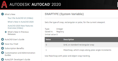

Hello!
We are having an issue with cursor snap.
When placing an object, we have a .lsp that grabs existing system variables commonly set to user preferences, sets them to the desired values for placing said blocks, and then returning those values to their existing  user preferred values after the block is placed. This may or may not be relevant.
On all our v2022 machines, and on other older versions in the past, this has worked without issue.
PROBLEM: Set up another machine using v2020 AutoCAD, and when placing the blocks it is like there is no snap at all.
Tried adjusting SnapGridLegacy at either 0 or 1.
Tried changing previous snap settings on or off.
Tried re-installing CAD and using no .lsp.
Any hints as to what the issue could be? The curser simply moves about freely and does not snap to grid, either before or when in a command.

Ya, quite possibly... But no, it did not. However, we are waiting for it to be available to test a possible fix I found in a thread talking about SNAPTYPE=0 or 1, as if it is set to polar instead of grid snap for whatever reason, it will appear as if snap is not working at all, and this appears to replicate the issue on our machines. Hopefully it is as simple as that...

Turns out it was as simple as that! SNAPTYPE was set to 1, we set it to 0 and the issue went away, the blocks placing normally. Who knows why that was changed... but glad it was easy.

@pendean wrote:
@travis_kowalchukR9P3E wrote:
Turns out it was as simple as that! SNAPTYPE was set to 1, we set it to 0 and the issue went away....
Explain please: nothing described above seems to be solve with that
It does for me, if I understand their issue correctly.  With SNAPGRIDLEGACY = 1 so that positional Snap works even with no command running, then with SNAPTYPE = 1 for Polar, no positional Snapping happens anyway [free-floating cursor], but it does with SNAPTYPE = 0 for Rectangular:
@travis_kowalchukR9P3E , is that what you're talking about?
Kent Cooper, AIA
Message 10 of 11
Yes, that's it exactly. We were unfamiliar with polar snap, so didn't realize that's what was happening... We just wanted grid snap and all we knew at first was the it seemed like it wasn't turned on lol.
