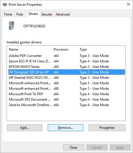

I am still having all kinds of trouble fixing this. Only it's with:
AutoCAD 2015 - Windows 10x64 - HP DesignJet 500 24
Tried all of the above, in addition to a few other things that I've seen around, and nothing has worked so far.
My HP DesignJet Printer Driver varies from a 6.07 to a 6.08. Can't get the 8.10 to take hold.

Hi, Did you uninstall the old version manualy ?
Win 10 is having problems with unistalling the old drivers
Left click on Win icon down left corner of the screen and got to RUN, paste "printui /s /t2", hit OK, search for Drivers, than find your printer - in your case HP designjet 24 and remove/delete all drivers
After that install the new driver and now it must be 8.10 version
Message 17 of 32
Yes, I've been through the manual removal and install process many times.
But still end up with the 6.07 driver, or sometimes the 6.08 driver somehow, but it still doesn't work:
