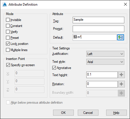

Does anyone know if I can pre-set suffix ("m²") so as I don't have to manually enter it in each instance of attribute?
4,945 Views
MMcCall402
You could add it into the default value of the attribute as text after the field.

Thank you, that solves the problem with typing it in in each instance. But since it is in the same space where I have to ADD FIELD, it makes the process slow. I have to pay special attention to not to click on the "m²" when adding the field. I hope Autocad will improve this function in the future!
