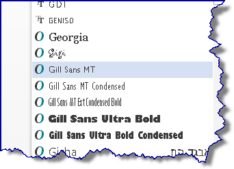

Alfred.NESWADBA
>> The TTF is Gill Sans
Are you sure it's a true type font? I just opened MS-Word, looked for that font and this is an OpenType-font, not a TrueType-Font (on my system)
Which operating system do you have?
What happens, when you start command _STYLE and adjust the width-factor to 0.95 or so (close to the current setting, but a bit different).
