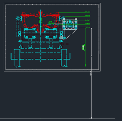

I have some sub-assembly views that are on a drawing and need to have reference dimensions on them. The problem is that I need the dimension to start from the floor and that is further away then the sheet will allow. (Due to customers standards, all nodes have to be within the paper). So I was wondering if I could create a hybrid associated dimension, were it would add what ever the distance to the floor is to the dimension I'm adding. So the equation would look something like "<>+1000", were <>=associated dimension. I have tried the insert field option, but I can't seam to figure out how to do what I want it to do. Any help would be great.

Here is an example of what I would like to do. On the drawing, the node is way off the page and I'd like to make it within the boundaries of the sheet border. So I would want to add what ever dimension I what to those dimensions (787.4 in this case). That way it would still be associated with the features above the rollers, but would add the distance from rollers to floor. Does that make sense?

Since you are limited in what you can do to meet the client standards, I think the easiest and fastest way to accommodate this is to create a non-plot layer and draw your baseline for measurement on it. Then add your dimension on this same layer. Next add a field to your existing dimension that reads the measurement of the new one.
While this is not terribly automatic, it does give you a consistent measuring point so you don't have to override all your dimensions to read correctly. You can also turn off the non-plot layer so it shouldn't affect plotting.
