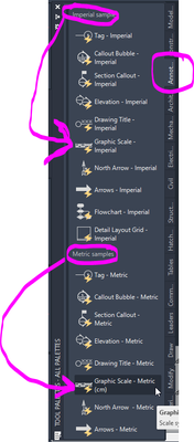

You only need to create ONE single SCALEBAR, 1:1 scale, annotative text to resize based on your viewport's ANNOSCALE setting, and place it in MODELSPACE next to our modelspace content so it appears inside your viewport that is inside your 11x17 titleblock in paperspace.
Autodesk provides all of us with a free example of that in ToolPalettes ANNOTATION Tab, looks like this
HTH

See this is where the issue is. You're stating it should go in model space. Unfortunately co. policy has us placing it in PS.
Thank you for pointing that out in the tool bar! I'll have a look and maybe that will fill in some blanks. Though based on you saying this should be in model space it may just add confusion, can this also work in PS? Maybe not in the way you describe?
