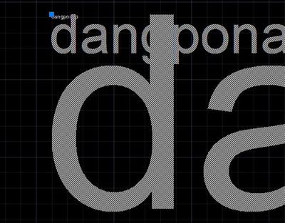

If you want the text to be in the same location at all scales as well as the same rotation, you can use "synchronise scale positions". Two ways to get it:
Annotate tab on the ribbonAnnotate tab on the ribbonRight click on the objectRight click on the object
The text position will synchronise to the grip point:
