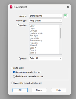

pr_wojtas
Good morning.
I had the same problem and found another way to “fix” it (for some reasons I cannot use the WBLOCK solution):
1. I am on a DWG where ARRAY does not work. In practice, the array is created, but you can't see it. How to check it? Select any object and go to Quick Select. Then Apply to: Entire Drawing; Object Type: Array (or Array Polar); Operator: Select All; How to Apply: Include in new selection set -> OK.
2. All the arrays in the drawing should be selected. In my case, the incorrectly created (invisible) array was also selected.
3. Having the “ incorrect” array selected: grab the handle of the object and try to move it - in my case, moving the “invisible” objects of the array fixes it.
