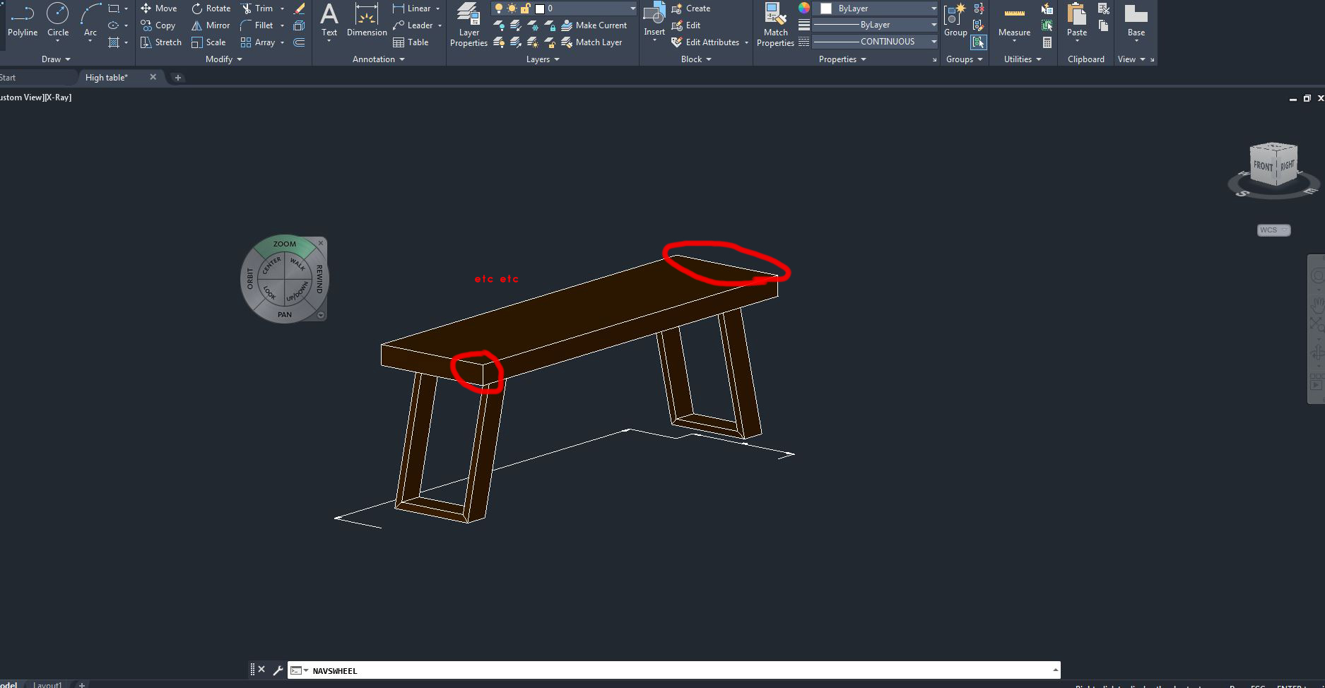

Hi all. I am trying to add dimensions to an imported 3D model (from cinema 4D) but the dimensions are all ground level on all axis. Is there a way this can be solved? Any help will be greatly  appreciated. Regards

On my side the following steps work when a dimension is created on Z=0 from the top view.
1. Change the view via viewcube to a different 3D angle
2. Enter MOVE command
3. Select the dimension object
4. Lift the dimension object to a certain z value.

try first to  UCS command >> Face ( F ) , after selecting your needed face on your model to align your ucs to the face that you want to dim. make your dimension now .

@imadHabash Hello again Imad, thanks for your response yesterday. Much appreciated. I don't use AutoCAD that often so I'm a bit clueless 🙂
I can't see where you are clicking on the drop down in the GIF you so kindly showed.
Can you please tell me on what you click?
Thank you so much
imadHabash
Dimension tab >> Linear
