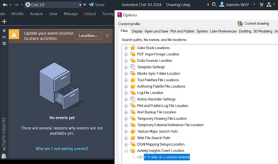

Why does the Activity Insights palette say I need to update my share location when it has already been updated?
Also, how do I prevent the Activity Insights palette from opening by default on first launch?

@b_ralphs ,
Consider changing this to a shared location (on a network), and it will go away.

b_ralphs
My screenshot shows that I am using a shared network location, hence why I'm asking the question.

Valentin_CAD
@b_ralphs ,
Try the "Full Path" instead of the double front slash... (copy it from the Windows address bar).

b_ralphs
This is the full UNC network path.
Just because it's not a mapped network drive doesn't mean it's not a shared network location.
Autocad runs fine with UNC paths.

OK, I figured out the real issue now.
The UNC path does work, but I was specifying a path that some users didn't have write permissions to.
I changed it to a different UNC path, and it works now.
I also tried mapping \\gecko to a network drive. The yellow warning box did go away, but no events were being logged. So, the error-checking system needs some work to let the user know they don't have permission to write to the folder.
