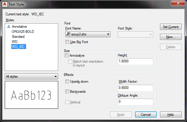

>> Else the WD-IEC font looks like this :
Please:
  • is it a SHX or a TTF font? Start command _STYLE, on the left side select the style that uses the font, then create a screenshot from that dialog and show this screenshot here
  • does the same bad display happen if you start a new drawing based on an original AutoCAD template, create a text-style using that font, create a text using that style ... same issue?
- alfred -

Wheelie22

And this is the default font for acad-E, the isocp2.shx.
Sorry, this here is the AutoCAD forum, so I can't know that from your previous post "WD-IEC font" was meant as "WD-IEC" is the style and that style is using "ISOCP2.shx" font 🙂
What happens if you change the style so it is using ISOCP.shx or ISOCP..ttf instead of ISOCP2.shx?
