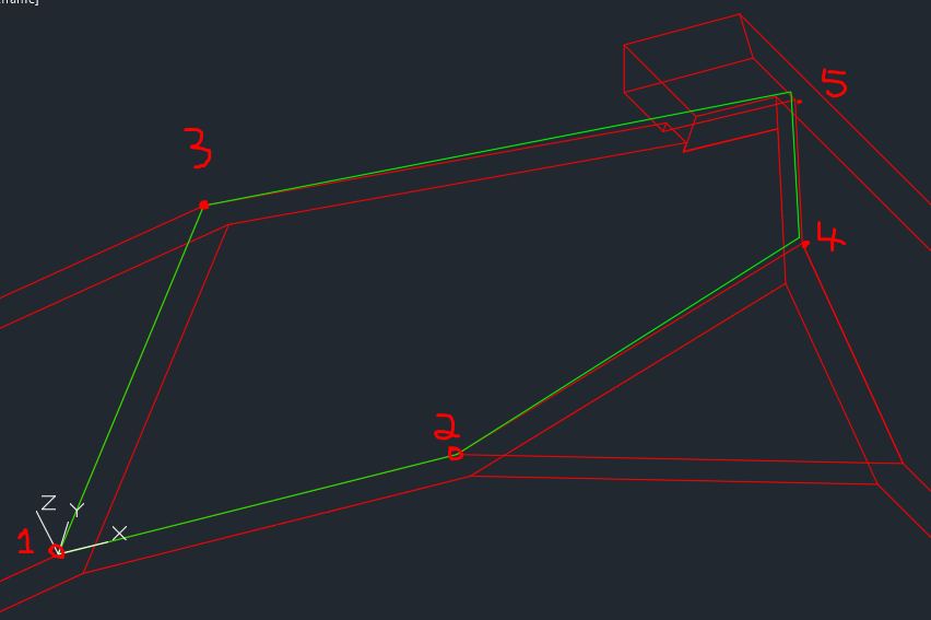

I was working with the following solid when I noticed that my snaps were not accurate at the corners of the model. When I zoomed in I noticed that none of the edges were connected. I'm not sure how this occured or how to fix it. I have more screenshots available if needed.

In the first picture are the three separate panels I made via extructions and some surface modeling. I attached them all together using corner snaps. I then created a very thin green 3D shape and subtracted that from the three panels to union them together, and level out the bottom of the assembly since it was uneven. The reason I need to join the parts is to create new panels that fit together, which I can do by sculpting out the correct shapes from the unioned assembly.
I'm not sure why the subtract command compromises certain connections on the model.

So is it this area of the model that you want to fix before slicing it up?
If so, define a ucs along the top surface and and add a box.
union it with the existing solid and use slice  and Boolean subtract to trim it.  Sometimes slice would post an error that the slice plane did not intersect the solid although it did.  In these cases I created a box and used Boolean subtract which did work.
I got to this point in  the process and found that one of the surfaces I thought was flat is not flat.
One way to ensure a flat surface is to create a UCS at the orientation that should define the flat surface and then create a polyline starting at the UCS 0,0,0.
The following image shows the 3 points used to define a ucs.  The green polyline are the points1, 2, 3, 4 and 5 projected to that plane.
I extruded the green polyline to with a taper of -30° to ensure that the edge surfaces of the extrusion would go beyond the adjacent surfaces while anticipating that they would be trimmed later.
The union of the two solids failed!   This leads me to think I should go back to your original geometry and work with the 3d wireframe model before it is given thickness and make sure the 4 surfaces are flat before making the shape a solid.
The image below shows the result of rebuilding the 4 shapes so that they are planar.  The shapes were then extruded with a taper of -20° and a thickness of 1.  The taper helps to ensure that gaps between extrusion are filled.
At this point we can use slice and Boolean subtract the clean up the geometry.  I had much better success with subtract than slice.
Here's the final trimmed shape.
