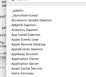

I removed all Autodesk products and files from my Mac except a little piece of software in the directory utility (see attachment) which I could not remove. I understand these files are protected and I am new to Mac, so I don't know yet how to remove it, but I believe I should have. Ran Nektony App Cleaner and Uninstaller but that didn't do the trick. Newly installed Autocad 2022 shut down again due to  "license that expired".
 Should I remove only the "_adsklic" or the "_launchserviced" as well .
Or skip all this and do a clean reinstall ?

But I have noticed that in the directory utility there is something that has to do with autodesk, and maybe the second on the list as well.
I have been told that these are not files but routines, but I don’y know how to end these routines.

I have done a you said and got rid of all Autodesk files, except the two routines or files in. the utility directory. I didn't know how to get rid of them.

 I refer to the fines or routines that appear in the utility directory
especially the adsklic on top and maybe also the launchservicesd
Do you mean Activity Monitor application?
I think you should try the solution from here:
https://knowledge.autodesk.com/support/maya/troubleshooting/caas/sfdcarticles/sfdcarticles/License-c...
