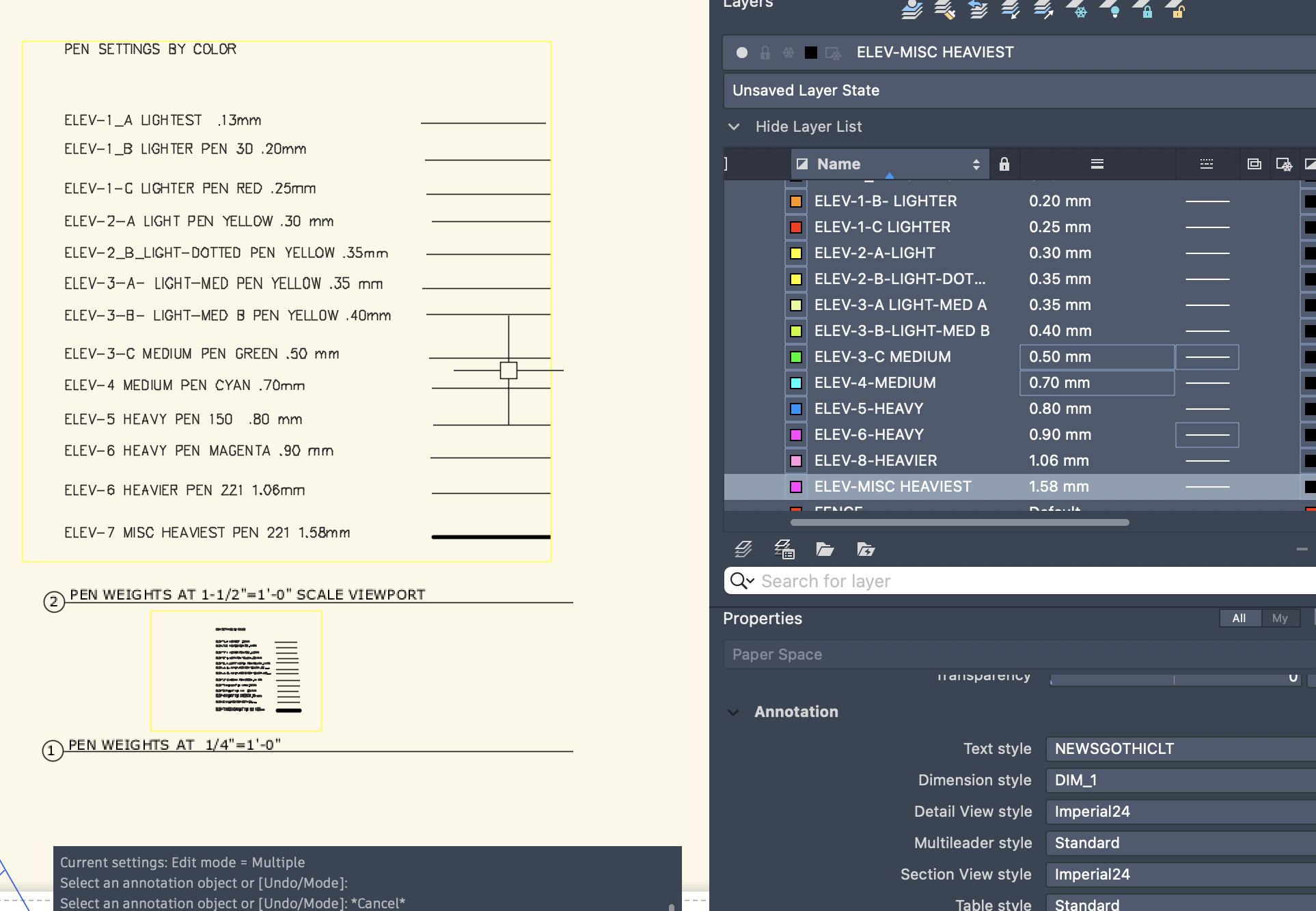

SO, based on your earlier comments, I decided I would ditch my custom ctb file and just use one of the Autocad standard ctb files. I tried both the monotone and the Acadlt.ctb files.
Then I went in and I isolated and clarified the line weights in a series of layers I might like to use. I had a range of between .13 mm to 1.58 mm. I set these line weights in both model space and paper space and I am very aware of the  icon toggle. That did turn what I had on and off.
I am still not having success. I have a pretty wide range of line weights and yet I get such little expression of the difference. Oddly, there is more difference showing when I have tiled into the model space then anything I can see in Paper space.  I have attached screen shots to demonstrate the problem. For example between .13mm, .20mm, 25 mm & .30mm  there is no visible difference. Then it jumps up. Again, between .35, .40mm, .50mm,.70mm, .80mm there is not a visible difference , and so on... I do notice a bit of shifting when I zoom in in and out.
I use paper space to see what my drawing will look like when I ultimately print a plot or a pdf, I think like most users.
With the attached screen shots showing the different views and situations, do you notice how the stepped gradation of thicknesses stops showing more than maybe 3 weights when I tilemode to Paperspace?
I’m on version 2023 and I think there is a newer version. Thoughts around this and an upgrade?

The lineweights you see on the screen in the drawing area are just a rough preview and are still dependent on the display resolution. That is why you do not see the difference in the gradations of the lineweights, which have a similar thickness, and the lineweights are displayed in jumps.
This has always been the case and does not depend on the version of AutoCAD.
You can see the real lineweights only on hardcopy (depends on printer/plotter physical resolution) or in PDF output (Preview button in Print window).
