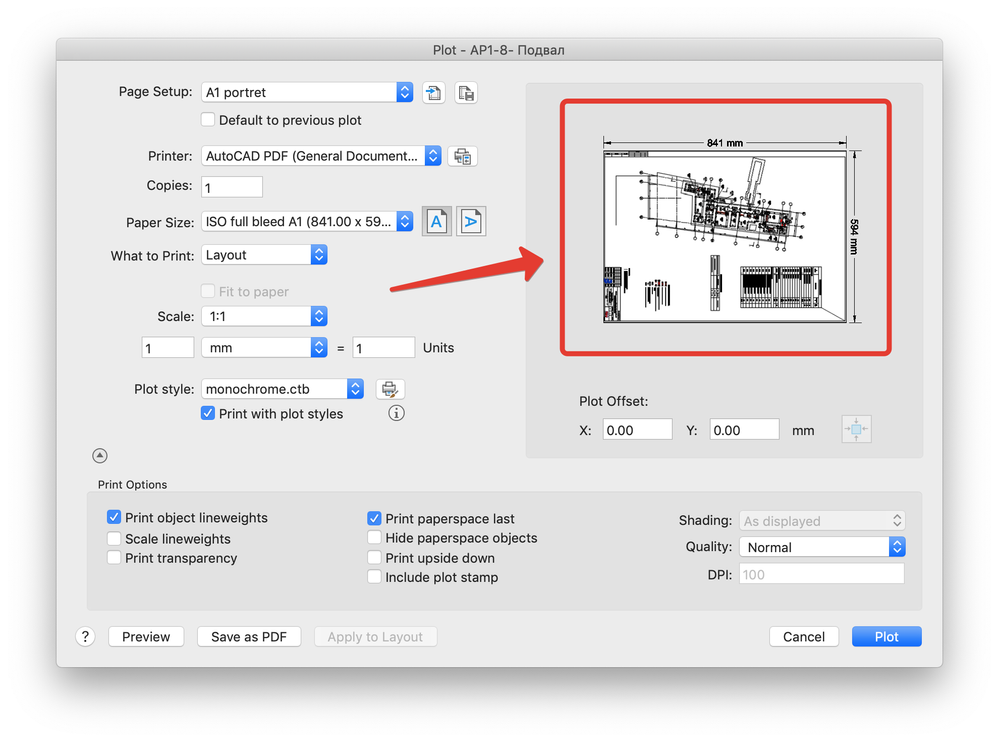

The article you referred is about AutoCAD for PC, but the question was about AutoCAD for Mac. Plot preview on Mac looks very different:
It does not depend on Lines Overwrite and has no settings.

Have you updated macOS to 10.14.4 recently?
If yes, that could be the reason of broken plot preview.
On my side on 10.14.3 preview shows correctly:2019-04-08_22-40-57.png
