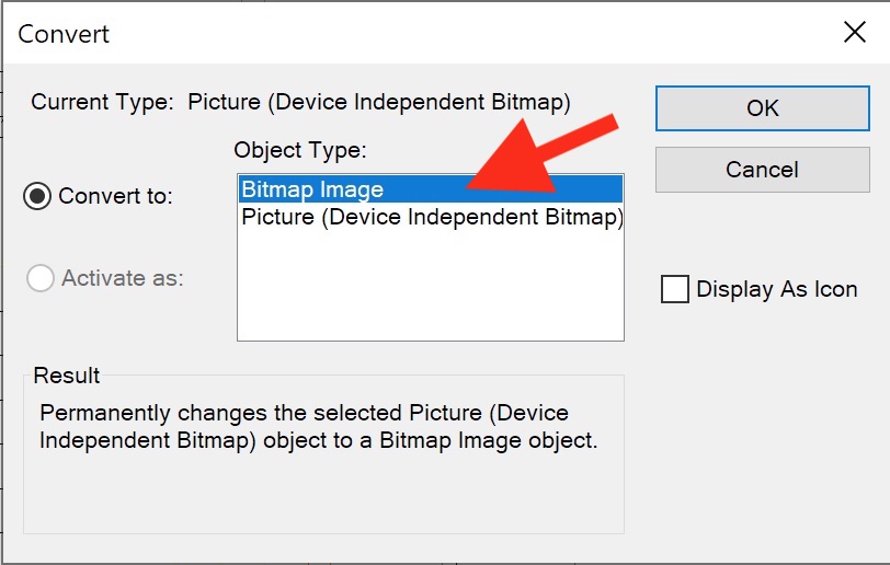

While I prefer to work on a Mac, I happen to work in a cross-platform shop, so we have the Windows version as well. I was able to open a drawing (with AutoCAD LT 2020 in this case) and right-click on the OLE object to open the context menu that gave me the option to "Convert" the DIB to a Bitmap Image. Once I did this, I opened the file on my Mac, and the image was now visible. At least there is a way to go back and correct the problem without having to track down the original image file and re-paste as special. A little annoying, but I won't look a gift horse in the mouth.
I attached a couple of screen shots to show the OLE menu options for others out there.
