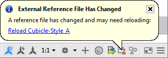

i don't know why sometime my autocad 2015 for mac don't blow up the notification for update from xref file ?
sometime it's appear but it's not for most of the time, i already try to change XREFNOTIFI TO 1 and 2

When you attach xrefs to a drawing, the program periodically checks whether the referenced files have changed since the last time the xrefs were loaded or reloaded. The XREFNOTIFY system variable controls xref notification.
By default, if a referenced file has changed, a balloon message is displayed near the Xref icon in the lower-right corner of the application window (the status bar tray). Click the link in the balloon to reload all changed xrefs.
If you close the balloon message without reloading, an exclamation point is added to the Xref icon. If you click the Xref icon, the External References palette is displayed.
By default, the program checks for changed xrefs every five minutes. You can change the number of minutes between checks by setting the XNOTIFYTIME system registry variable using (setenv "XNOTIFYTIME" " n ") where n is a number of minutes between 1 and 10080 (seven days).

>>>i don't know how to change the setting of XNOTIFYTIME system registry variable
It is easy enough:
At the command prompt type:
(setenv "XNOTIFYTIME" "1")
and hit Return.
This will set number of minutes between checks about changes to one minute. (By default, the program checks for changed xrefs every five minutes)
I also can suppose if your external references are on the network drive, you can have delays in notifications regardless sys var settings.
