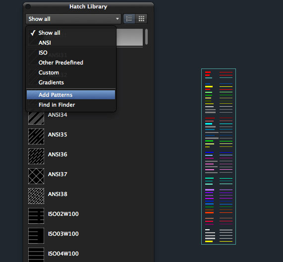

A client of mine uses Autocad LT 2014 for Mac and downloaded some new hatches from this location: http://www.bibliocad.com/search?s_qpage=1&s_qtext=hatch&s_qver=sall&s_qmode=sor
They are all .PAT files.
At first when she loaded them in they were working, however after reconnecting to the onsite NAS, she is now getting error messages from Autocad saying that Autocad can't find the .PAT files even though they are still in the same location as they were previously while they were working.
She used the Add Patterns inside the Hatch Library to add these .PAT files in.
When she tries to re-add these .PAT files in, the gets a non-descriptive error message.
At this stage we'd be happy if we could just completely remove the new Hatch files and not worry about them. If we can't fix this, we'll have to reinstall Autocad and see if that works.

When you add Hatch pattern in AutoCAD for Mac using "Add Patterns" form Hatch library palette, AutoCAD adds symbolic link to the pattern file inside "~/Library/Application Support/Autodesk/roaming/AutoCAD LT 2014 Standalone/R19.1/enu/Support" folder, so if the folder from which it was added is no longer available (as in your case), than AutoCAD cannot load this PAT file from the original path following the information in the symbolic link.
If you want to remove patterns from Hatch library palette, you need to go to the "~/Library/Application Support/Autodesk/roaming/AutoCAD LT 2014 Standalone/R19.1/enu/Support" folder (the Library folder inside Home folder, but not in the root of Mac HDD) and trash all symbolic links to the PAT files.
Be careful not to trash acadltiso.pat and acadlt.pat files!
In a future if she want to add hatch patterns, it is better do load them from the local disk, but not from Network path.
