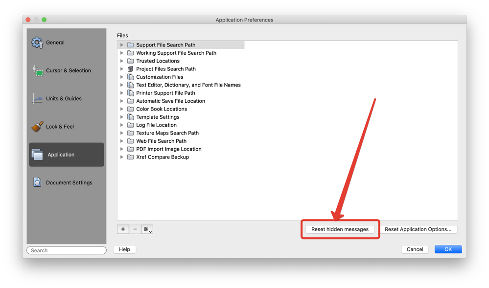

The problem occurred because once when using "delete" from context menu on Layers palette, you selected "Delete layer and its content" with "remember my choice" option checked, like here:
From this moment AutoCAD Neve asks you what to do when you use "Delete" context menu item in Layers palette.
Now all you need to do is Reset hidden messages, and here is how-to:
1/ Launch AutoCAD, open any of your drawings where you can delete layer
2/ Use context menu "Delete" on Layers palette to delete layer and its contents
3/ Open AutoCAD Preferences and go to Application tab, pick on "Reset hidden messages" button, then OK:
 4/ Now try to use "Delete" from Layers palette context menu again.
Do you see an alert from AutoCAD?
