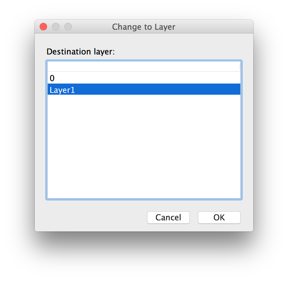

I am trying to highlight drawn objects and place them on the layer I wish them to go to in AutoCAD 2014 Lt for Mac and I can't figure out how to do this. Help please!
Delia
Message 13 of 18
maxim_k
Welcome to Autodesk Forums!
Select objects in the drawing area, right-click and select "Move to Layer" from context menu:
Another window should open where you select destination layer:
Please also verify that System Variable PICKFIRST=1:
Command:
Command: PICKFIRST
Enter new value for PICKFIRST <1>:
Command:
