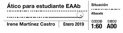

I'm having an issue with Autocad when printing the drawing.
I use Helvetica and Helvetica Condensed and when the file is ready, some parts of the texts are missing/not legible, but it's the same font!
Am I missing something? Please help!
Thank you in advance...
Ps: I let you see what is happening in this screenshot, the dots are mean to be the same fonts, both fonts are failing and working at the same time.

Thank you for caring, I see the problem when I plot the drawing. While I am working on AutoCad it appears without problems.
My Mac Version is: Mojave 10.14.2
Autocad 2017
And the screenshot with the font info (The Helvetica Neue has the two typefaces I'm using: Condensed and Bold)
I attach the drawing too, the problem is on the layouts (the names are: A10 - Situación y Emplazamiento and Para bocetar), on the title block I'm trying to make.

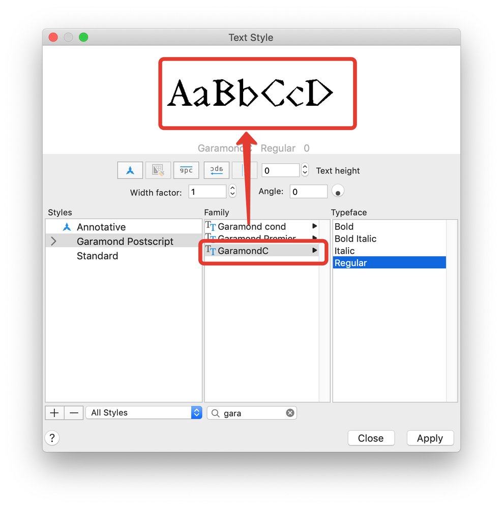

That is because of the nature of the font you are trying to use. I believe it is Postscript font (not true TTF), which even is not supported in Windows version of AutoCAD, but still supported on Mac platform.
I'd suggest you to avoid to use such kind of fonts.

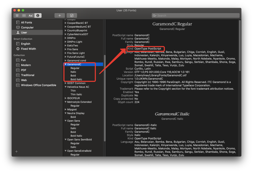

You can find out the type of TTF (OTF) font with Font Book app. Here is an example of Postscript kind font:2019-01-01_01-33-13.png
And here you can see how does it look in Text Style dialog in AutoCAD:
