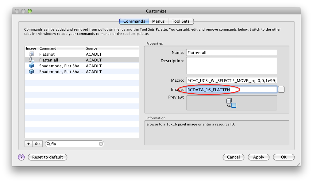

After you select this macro from menu or from ToolSets, you have to select object(s), hit Return and everything you have selected will be flatten (even 3d solids, meshes, 3d polylines ad splines)
EDIT: if you will put this macro to ToolSets Palette, you can even attach an icon from "real" ExpressTools command, just type RCDATA_16_FLATTEN in image field in CUI editor:
HTH
