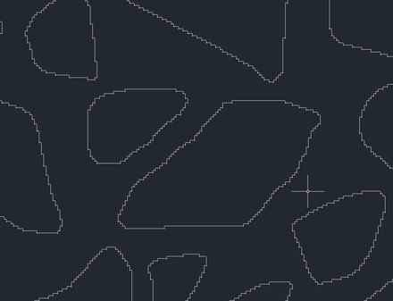

I downloaded a .pat file for landscape plans, but curved lines show as staggered when I import them to autocad.

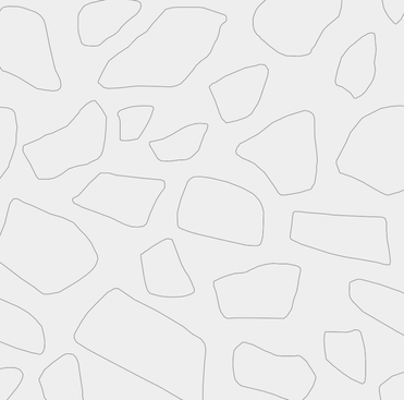

This is the preview from the website I downloaded the .pat file from:
And this is the same pattern in AutoCad:
What am I doing wrong? Is there a way to fix this?
I've tried exploding and redrawing, but nothing happens.

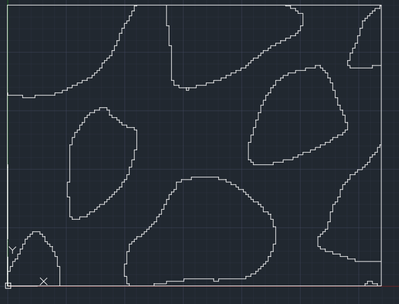

jatBYJCA
Hi Maxim,
Not far. I tried drawing a rectangle with one corner in 0,0 now with the same error:
I'm drawing in millimeters and the rectangle is roughly 65x65mm big.

Thanks for sharing the PAT file: it looks to badly written/coded for a 1x scale, it look the same here for me
Unless you set the scale to be really small (1/10 scale below, same rectangle)
Message 7 of 9
maxim_k
At first glance it seems that such lines are included in the pat file.
