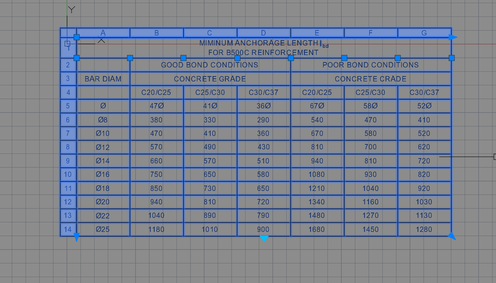

How can I reduce the column and row in the table?
(note: when I inserted the table, it was too big I had to reduce the size of the latter 10 X)

ruirego
hello Maxim,
its not the cell, its the top cell (the grid).
i think it has something to do with scale?! because i tried to insert a cell in a new  file without scaling down and it was fine.

ruirego
hello maxim,
not the header size. the row's and column size. please check my image
maxim_k
Hi @ruirego ,
The size of cells of column letters and row numbers depends on text size of the title, header and data cells. Plus there is relationship between text height in title, header and data cells and settings of MEASUREMENT and INSUNITS System Variables.
If you have the drawing with MEASUREMENT=1 and INSUNITS=4 (typically the drawing created with metric acadiso.dwt template) and the size of text for the cells in current Table Style is too small - for example: 0.125 units - the table will look like this:
If you set text size for the cells to 4 in the Table style in the same drawing and create new table, the table will look like this:
