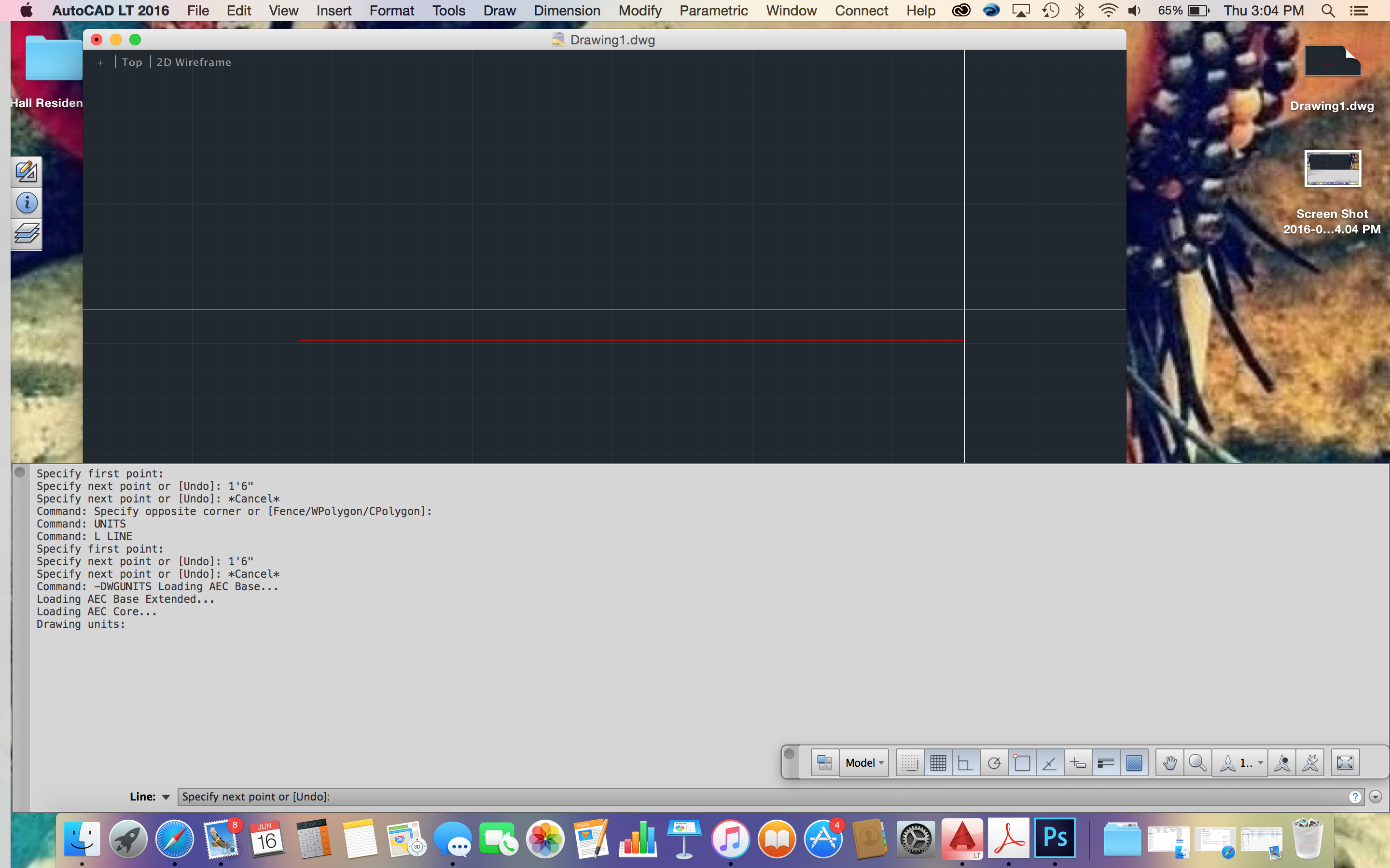

Thank you!  I have done what you asked.  Here is the screen shot, although there is nothing to see, because when I type in the dims of the line, it doesn't even register it in the command line.  As mentioned, it is as if I have not performed the line command at all, not typed in any dims.  The line command remains active until I am forced to hit escape to get out of it.
Thanks for your help!!  I really don't know what to do!!  But something is wrong.

Everything works fine in your drawing, I'm able to draw line 1'6" long with direct input method.
BUT it is practically invisible in the drawing area, because drawing window shows an area 168539'10-5/16" x 99767'11-7/8" units and the line 1'6" length looks like a small point.
You need to zoom in 10000 times to be able to see this line.

In your file those teeny tiny "dots" are all the lines you've been drawing but not seeing, each is 2' or 1'6 long. You have to zoom in that far down to see the line.
Looks to me like you lost how far out you have indeed zoomed. Your drawn red line in 32,387 feet (6+miles) long in your file.
