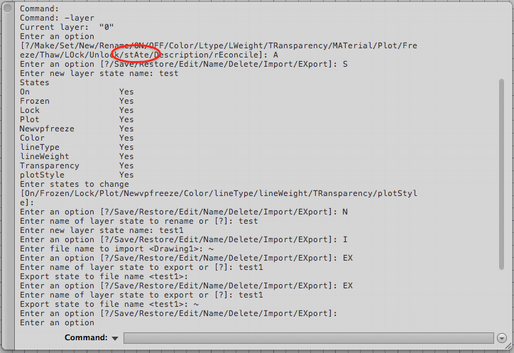

Message 6 of 28
stAte option in the -LAYER  I tried looking for this in the menu or command, but I was unsuccessful.
Please help me find this command. Thanks
Hi xaffier,
Layer State option is here:
HTH
Maxim

Message 9 of 28
Thanks for the tip. I have found it but it didn't help about Layer Manager issues.
