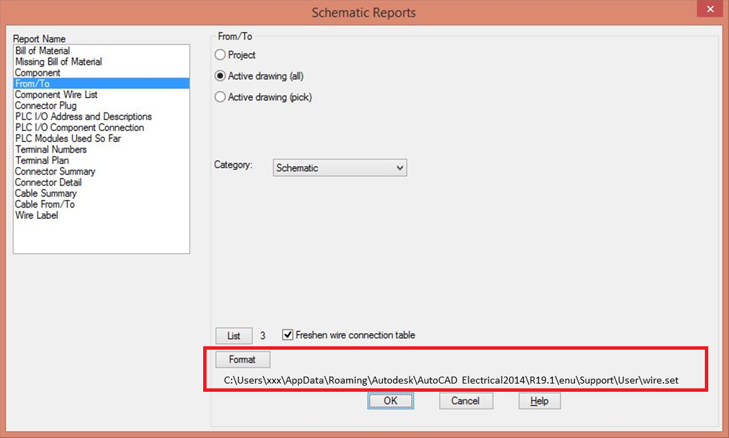

So today's idea is how reports are used in a project and how the designer/engineer utilises them
First issue when you run a report from the schematic reports menu
You are unsure which set files ACADE is currently looking at you may be in the correct one or you simply might have a requirement to generate a report in a different format for example one for internal use  and another format for issued docs to your client
So it would be beneficial on the schematic reports menu to display which set file ACADE is currently using as a template when selecting a report
to generate something like in the picture below
Second issue would be either the automatic report generator loading automatically your default saved Settings from a grouping file already saved inside your project
or a new menu which shows all the default set files being used and a method of selection for the project
this will be automatically load when you open the project and be saved when you close the project
And finally to tie this all together with a setting on the copy menu to copy all set files used by the project being copied so if your emailing to a colleague etc you have the all the set files so the end user can generate reports
yes i know you can do some of this with the automatic report generator but not all this method is more flexible and adds a set of user default settings automatically  to a project

You forgot the most important part in my opinion...
A PREVIEW of what columns the report is going to show, maybe with some dummy data or data taken from some random components in the current dwg. Then you would know exactly what is going to be shown in the report. This would be handy if you have three or more report formats for different circumstances that are just labelled as report1, report2, report3 and so on.
Other than that, I agree with the changes you said.
Regards Brad

yes a preview would be good the code is there something like whats siting in the laout tab in the terminal strip editor

Regarding the default location for .rgf and the .set files... I've heard these are considered system files, not project files.  I see this as an issue.
As it sits, creating report format files is a huge bottleneck in the workflow I envision, if I have to modify those files through the program every time I want to produce reports for a project.  Plus, if I have everything set for one project, switch over to another project and have to touch all those .SET files again, then want to switch back and run reports again for the previous project say due to engineering changes, then adjust all the files again… that’s just nuts.  In our networked project storage standard, where each project has it's own master folder with all documents stored beneath that tree, we would like to be able to easily repeat the automatic report function.  Our .set files are configured to output Excel files, in the locations where each project is stored, not some master central location.
For our environment at least, it makes way more sense to have those files all follow the project & be stored in the same location as the project file.  Then as I switch from project to project and want report function to create Excel files in their respective project folders, I don’t have to be concerned that I’m overwriting anything.  So the issue becomes:  how to efficiently copy the .rgf and .set files and update the folder locations they reference PER PROJECT.  Just like the copy project function allows for file renaming and data changing during the process of copying to a new project, so should those report files be available to copy and modify per project.
I'm on the verge of writing code for a post-process that will accomplish this & save me the tedium of dragging each file into a notepad and modifying the paths specified within.
