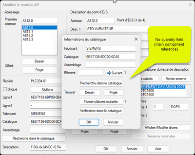

Unlike in the component edit, where a quantity can be specified, this option is not available in the API edit.
Why?
When I generate the parts list for my schematic, I am always forced to manually enter the quantity of the main API component. However, this works fine for references in multiple bills of materials.

amaillardS7EJT
rhesusminus
Almost... You can't attach images when answering by e-mail.
