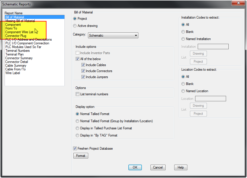

For a TO/FROM report you might take a look at this tool.  The report can be exported to a spread sheet.

Sorry I may not have explained my issue in detail enough...
Upon generating the FROM/TO report, I have a schematic which has a PSU unit 24V+, wired into multiple terminals around the schematic.
When I generate the FROM/TO report, it gives me the wiring sequence. i.e. 24V+ --> PIN22, PIN22 --> PIN45, PIN45 --> PIN60 etc.
What I want to achieve is the 24V+ as the source for all pins, i.e. the expected output to be:
24V+ --> PIN22, 24V+ -->PIN45, 24V+ --> PIN60.
Is there any way to do this without having to edit every single line of the report?

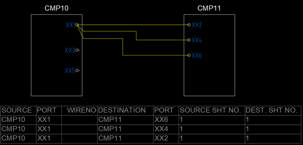

Hi Brad, thanks for your reply, still trying to understand how you were able to generate the report from the wiring diagram sample you posted back on the 10-04-2017, this wire sequencing issue continues to be the main problem to resolve in our use of ACADE, any ideas are most welcome, John

Hi Brad, thanks again for your reply, I was aware that the SORT command can arrange the source-destination sequence as required.
Unfortunately when the report is updated/rerun this sorting operation would have to be corrected each time to output the required report details.
We are currently using this method (refer snapshot) which provides the report outputs required, but this can look at bit untidy and take up a lot of space on the drawing sheet when there are many of these connection types. I will post a comment in the idea forum to highlight this shortfall in wire sequencing.
Regards, John
