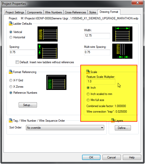

Hi there,
Couple of thing I would check.  You are inserting from the JIC library so I would make sure the scale of the drawing area is correct.  Any chance you are inserting into a drawing scaled for IEC?  Another thing to check would be the ACE scale factor.  That would be to right click on active project in ACE project manager and open OPTIONS.  Of course other thing can cause this but try starting there.  But before you do that, what happens if you activate the ACE DEMO project and add the component there?
Good luck
