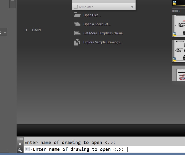

My Autocad days are few and far between these days, so hopefully this is an easy question.
From the Getting Started page, if I click "Open Files", I get a prompt in the command line to enter a file name.  If I enter (manually) a valid path to a file, it will open.  I would expect that clicking "Open Files" would take me to an explorer window where I can browse to my file(s).  And once I've clicked on Open Files, the rest of the program is "dormant", waiting on me to enter a file name.  EVERYTHING else is either dimmed or inactive at this point.
Any ideas on why I'm not able to browse to the file??
This Acade 2016 is part of Inventor Ulimate (or what ever they're calling this week).
Thanks!
Chris
2,597 Views
rhesusminus
Type FILEDIA on the command line, and set it to 1.
That should take care of it.
