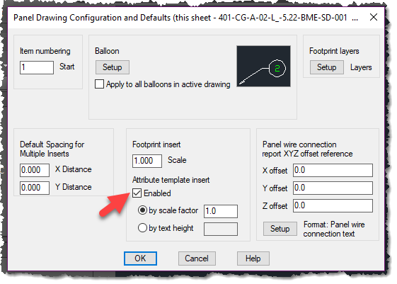

The attributes the guys are taking about only gets inserted into the footrpint (if they don't already exist) if this checkbox is checked:
