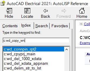

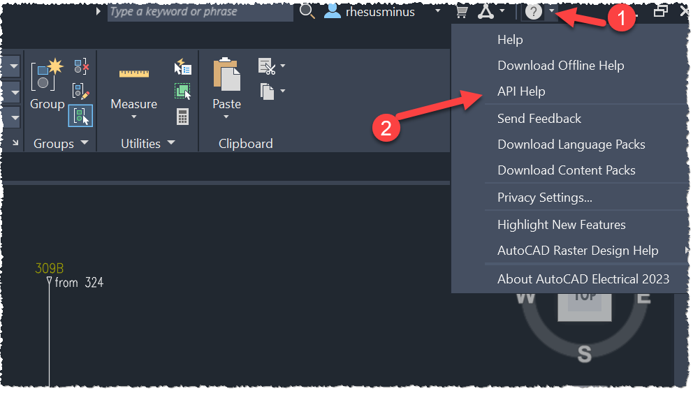

How about looking into the API help?
(c:wd_putwnxy) should do it.

Doing a quick search would show you there is nothing to be found rhesusminus.
This menu often helps, but not today.

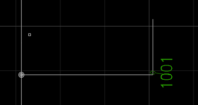

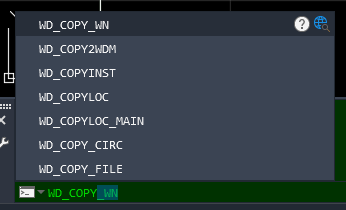

After the command "WD_COPY_WN" is entered, it asks to select a wire. It does not accept a coordinate here. I am able to command "LAST" but the Wd_wch (wire copy) block is placed  in unappreciated location.
